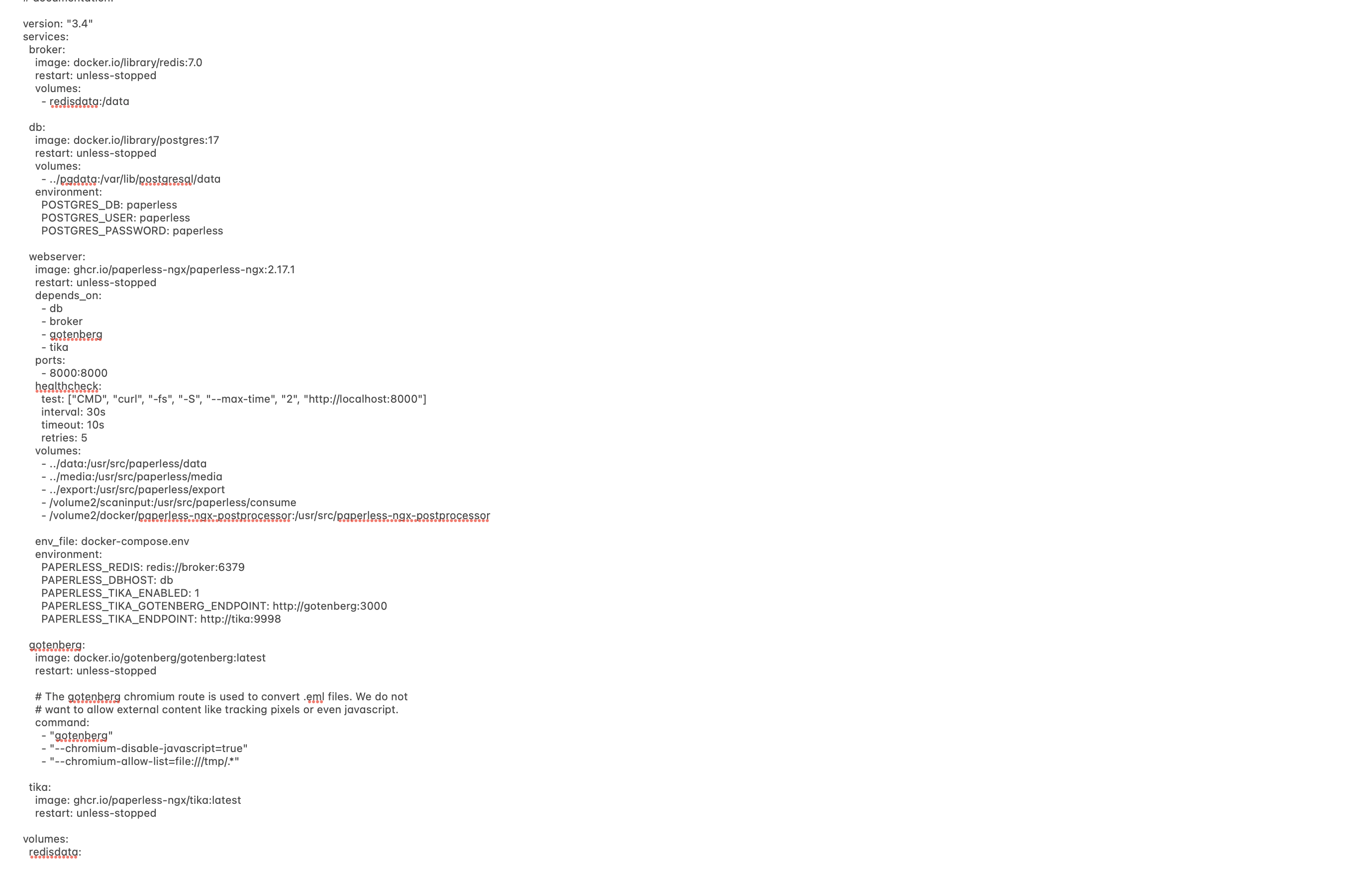

Poste mal eine docker-compose, nicht dass du ein Volume in Docker angelegt hast.
Meinst du die .env oder .yml?
docker-compose.yml, dort sind die Volumes hinterlegt

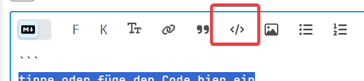

ich kann hier nichts einsetzen, da ich neuer Nutzer bin…
Ich stehe hier echt auf dem Schlauch:
Wie bekomme ich hier etwas hochgeladen?
Danke. :slightly_smiling_face:
# docker-compose file for running paperless from the Docker Hub.
# This file contains everything paperless needs to run.
# Paperless supports amd64, arm and arm64 hardware.
# All compose files of paperless configure paperless in the following way:
# - Paperless is (re)started on system boot, if it was running before shutdown.
# - Docker volumes for storing data are managed by Docker.
# - Folders for importing and exporting files are created in the same directory
#   as this file and mounted to the correct folders inside the container.
# - Paperless listens on port 8000.
# In addition to that, this docker-compose file adds the following optional
# configurations:
# - Instead of SQLite (default), PostgreSQL is used as the database server.
# To install and update paperless with this file, do the following:
# - Copy this file as 'docker-compose.yml' and the files 'docker-compose.env'
#   and '.env' into a folder.
# - Run 'docker-compose pull'.
# - Run 'docker-compose run --rm webserver createsuperuser' to create a user.
# - Run 'docker-compose up -d'.
# For more extensive installation and update instructions, refer to the
# documentation.
version: "3.4"
      - redisdata:/data
    image: docker.io/library/postgres:17
    image: ghcr.io/paperless-ngx/paperless-ngx:2.17.1
      - gotenberg
      - tika
      - 8000:8000
      - /volume2/scaninput:/usr/src/paperless/consume
      - /volume2/docker/paperless-ngx-postprocessor:/usr/src/paperless-ngx-postprocessor
    env_file: docker-compose.env
      PAPERLESS_TIKA_ENABLED: 1
  gotenberg:
    image: docker.io/gotenberg/gotenberg:latest
    command:
      - "gotenberg"
  tika:
    image: ghcr.io/paperless-ngx/tika:latest
  redisdata:
Schaut eigentlich ok aus.
